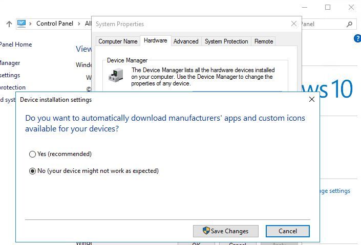

Para deshabilitar update automatico do drivers, precisamos abrir Control Panel->System->Advanced System Settings->Hardware->Device Installation Settings
E selecionar No
